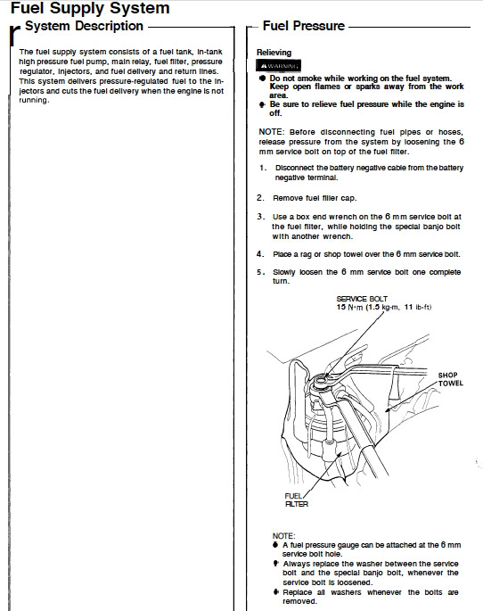

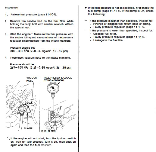

You need to hook up a fuel pressure gauge to the fuel filter and then measure the pressure with and without the vacuum hose of the fuel pressure regulator connected. Be sure to pinch the end of the vacuum hose after disconnecting it.
