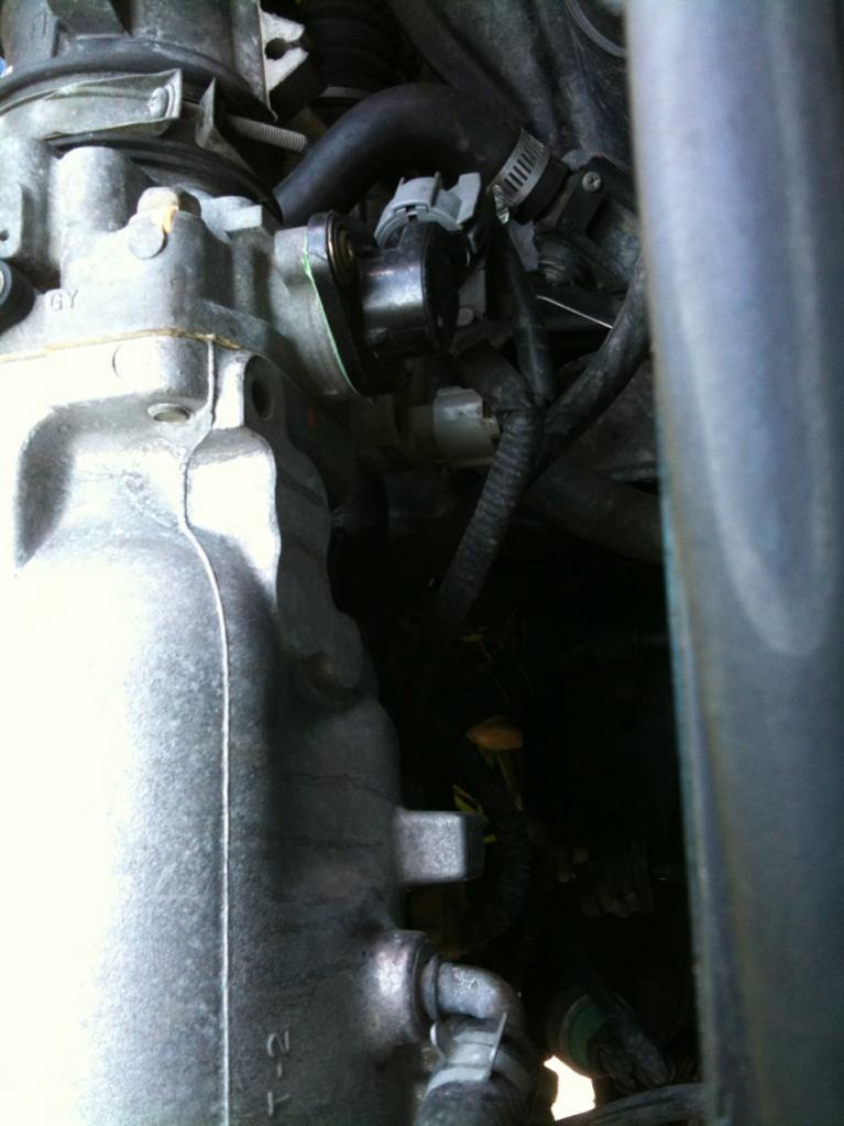

from what i've seen this is where it should be but as you can see i have nada. general questions on my 98 EX-iacv.jpg
Old Sep 13, 2009 | 06:36 PM
  #22
I have never seen that before. Very odd.
Oh wait, I don't think the automatics have an IACV.

Automatics have an IACV, but it's on the bottom of the throttle body not the back. It's a different type of valve (the so called "3 wire IACV") but I would imagine it can still get dirty and cause idle speed problems.
