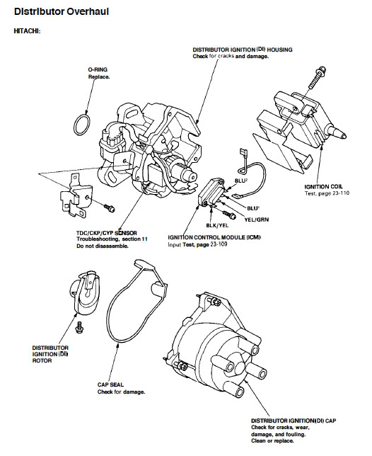

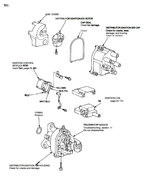

Old Jun 12, 2009 | 05:40 PM
  #25
So you have fuel. That helps. Given your fear of checking for spark, let's just assume that you don't have spark in order to move the process forward. Remove both the ICM and coil from inside of the distributor and call around to auto parts store that will test them. One is likely to test bad and replacing it should get your car back on the road. Nonetheless, when either the ICM or coil goes bad, the other isn't far behind, so consider replacing both. Good luck.
