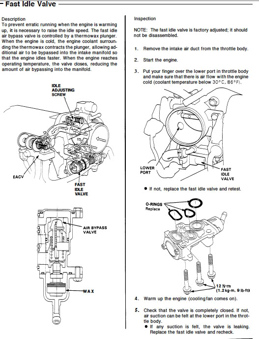

1) Have you checked the condition of the spark plugs, distributor cap, and rotor?
2) Regarding the low idle when cold, check the fast idle valve (see diagram).
3) What parts of the emissions test did your car specifically fail (e.g., hydrocarbons, NOx, etc.)? If only hydrocarbons are high, then check for a stuck open thermostat, an intake air or vacuum leak, an exhaust leak upstream of the O2 sensor, a bad coolant temperature sensor or O2 sensor, or a bad catalytic converter.

A faulty fast idle valve on the throttle body can cause problems with cold starts. The diagram shows how to check whether the valve is malfunctioning.
With respect to running rich, does the engine take abnormally long to warm up? Is there a crack or leak in the exhaust manifold? Once the engine starts, is the idle speed normal?
