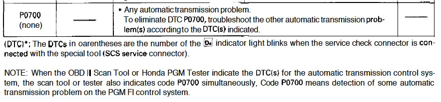

0700 is a generic AT trouble code (not informative). Retrieve the specific AT trouble code similar to a CEL code (see below). Again, post codes for more feedback.
