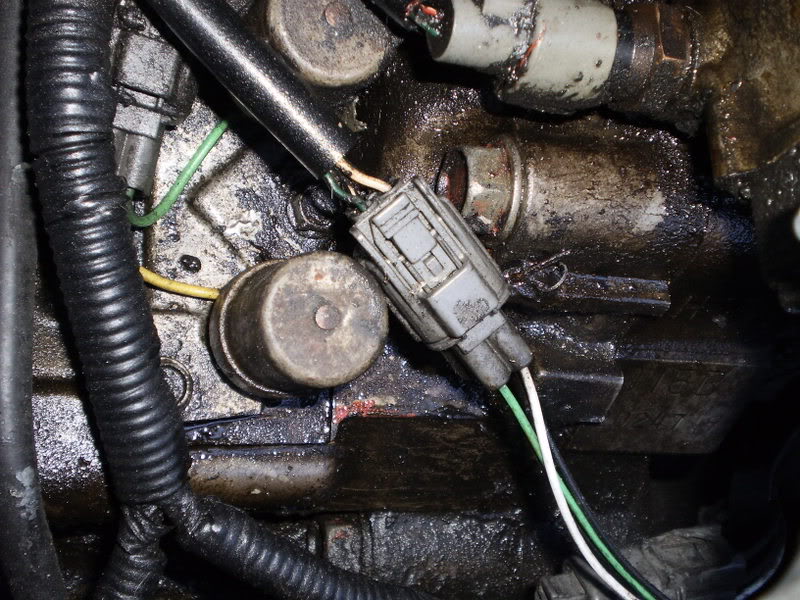

It asks for size....I'm guessing at this point I need standard. Then it says Thrust Washers (if applicable), duno what that is so.....ok, don't know how or when vtec engages sad to say. All I know is there's one solenoid that just sits there unconnected (guessing due to replacing the Y7, and one cut wire right above the oil filter but none of those ever seemed to affect operation or performance. A friend of mine suggested that I should use strictly antifreeze if I decide to go ahead with the overhaul because coolant eats out stuff a lot faster. I really may sound like I have some idea of what I talk about but I don't as much as it'd seem, I just try to learn enough to give you guys info in the right direction

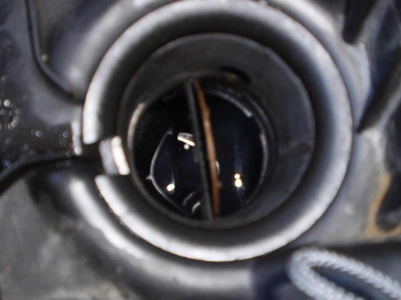

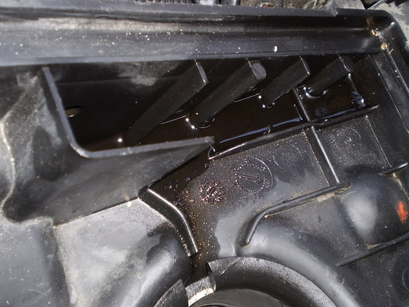

Lol actually I posted that link to ask if a kit containing all these components would be good, if you notice, I did say my cousin could get it when he goes to the US and it would make no sense ordering since duty & freight would be high based on weight and dimensions. Thank you for clearing up the antifreeze, i think he said to get a good one that's already mixed. So is a kit like that ok? I mean with all those components and a good y8 gasket kit. I think things would be a whole lot easier if my uncle would stop b.s'ing me and getting me to by an entire overhaul kit. If someone could tell me the EXACT problem that'd be great, I'm sure it can't be that bad, the car can drive but I dare not. There's just pressure building up and the oil is coming up out of the air filter box along with alot of steam. Maybe getting a short video clip or some pictures would assist so someone can actually SEE what I'm talking about?

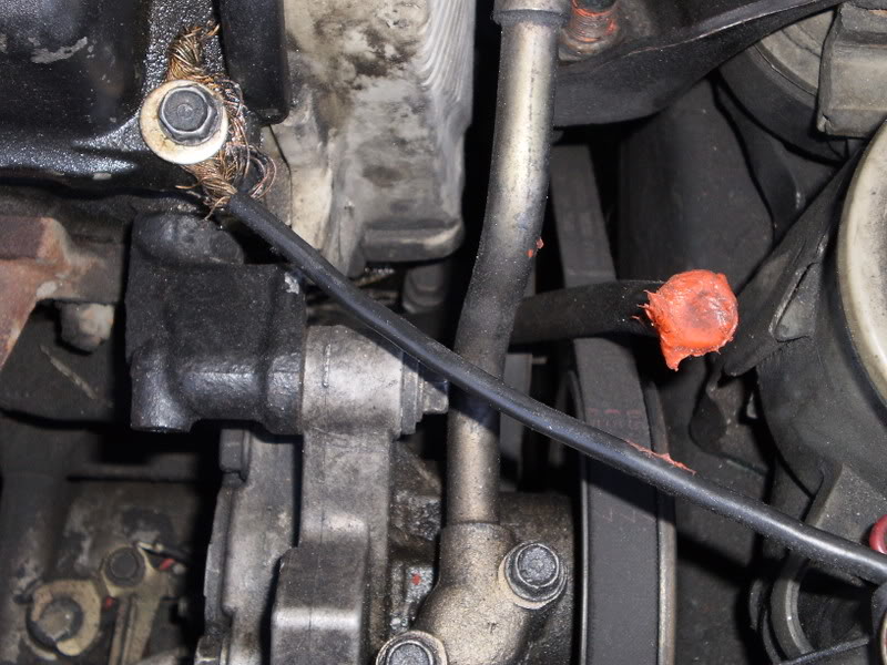

There's also a muddy brown color in the radiator which originally I thought was just because it needed to be steam cleaned or rodded out (whatever it's called) but another uncle told me a few minutes ago that it could be a blown head gasket but it's been that way about a month before the other problem so any input would be great. Sorry I didn't walk through on the video but it should still be self explanitory, didn't know the camera was recording audio since when I originally did the recording there was no audio playback, turns out it was just the camera (I feel like such a camera noob lol). By the way, the hose that goes from the valve cover to the steel pipe to the other hose to the air filter box (don't ask) was broken at the tip so I cut it off and placed the hose back on reluctantly but no shops had a new hose (just to let you know to clarify all angles for accurate input). Thanks.
