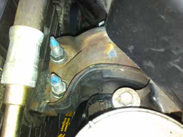

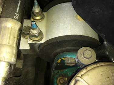

Default different mounts????? B and D series mounts are different!!
here is a picture of the B16A mount i needi ned a motor mount for a b16a jdm in a 1994 civic si....what part???-b16a-19.5kb.jpg, its a 2 bolt, the D16Z6 mount is 3 bolt pictured herei ned a motor mount for a b16a jdm in a 1994 civic si....what part???-d16z6-19.5kb.jpg
i want to order a honda hydro stock mount rather than a aftermarket one, which part number or car has the 2 bolt mount? is it a integra gsr or del sol vtec or another car???

That three bolt came from an Integra or B18 motor I would guess. The 99-00 Civic SI has the 2 bolt.

Aren't those the same if you were to leave out the third bolt? You may need to replace the bracket on the engine with one from a Civic.

no the bolt are too close together, won't align, which should i try, a 99-00 civic si
, or a 1994 integra vtec, which would work best? or are they the same

I think its either part number 50820-SR3-J11 or 50821-SR3-020
