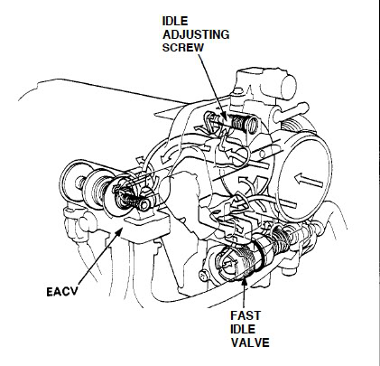

IS THAT THE DIAMOND SHAPED ONE ON TOP OF THETHOTAL BODYOR THE BIGCYLINDER THING BEHIND IT
Old Jun 25, 2008 | 12:06 PM
Default RE: idols up and down please help asap
By the way, you need to insert your signature picture into [IMG][/IMG] rather than [IMG][/IMG].
