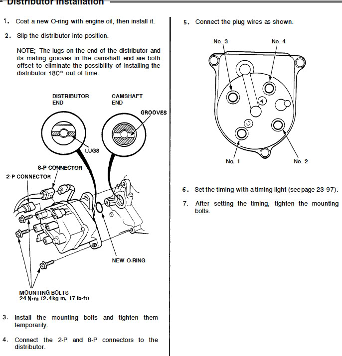

Old Apr 12, 2008 | 01:52 PM
Default RE: ignition problem please help
I believe mk is referring to the inner cover in the distributor (see picture 1).
The firing order for the distributor is shown in picture 2.

Old Apr 12, 2008 | 06:22 PM
mk378's Avatar
Posts: 10,023
Yeah the inner cover. Guess it's not so much of a plate as I remember it.
I'm thinking it could have been gone all along (these things happen when you buy a used car), it can run without it but it'll be more susceptible to damage from excessive voltage which happens when running with one of the spark plugs disconnected.
