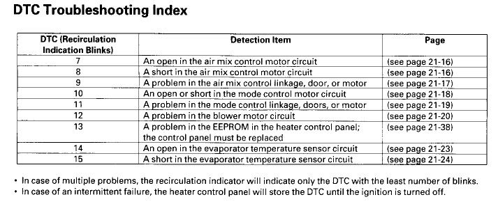

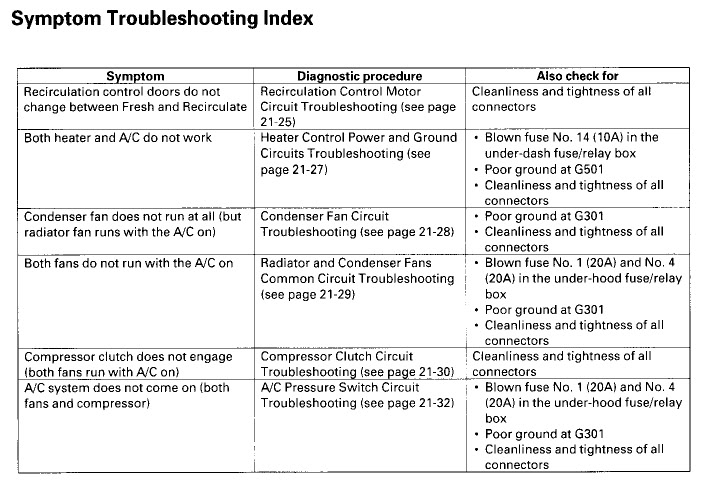

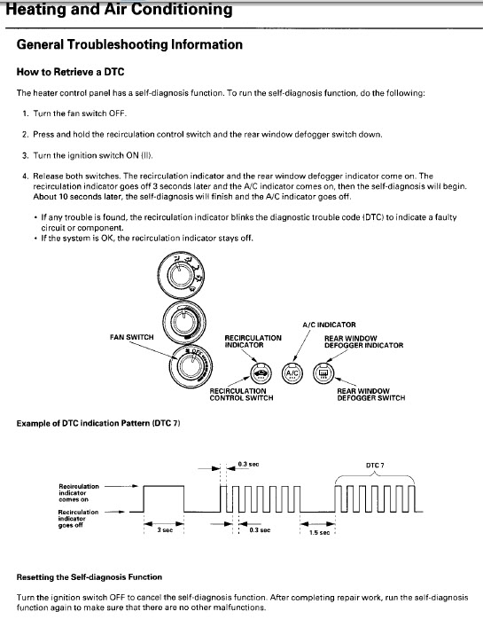

Old Nov 11, 2008 | 09:03 AM
Start here:

DTC index = 12....what do i do from here? thanks
