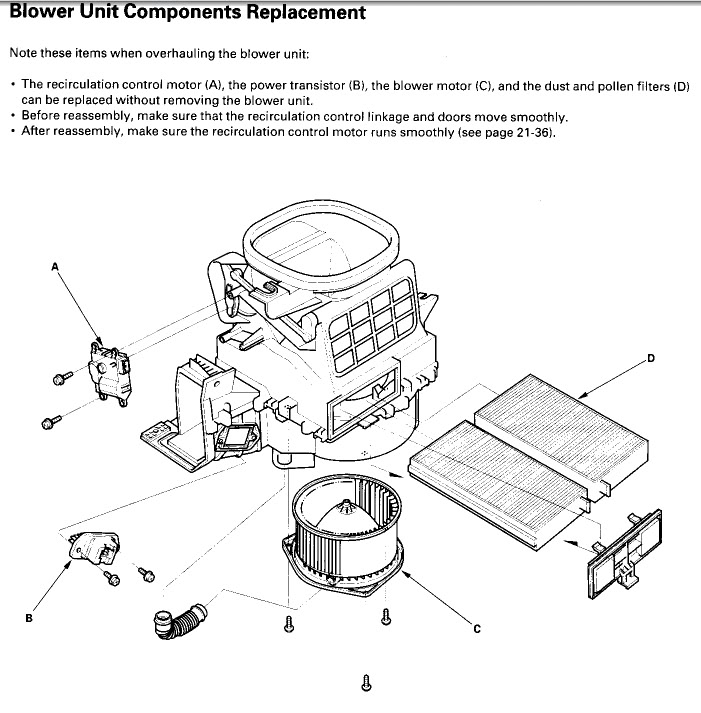

Yeah, sounds like the blower motor is bad. It'll drop right out with removal of three screws:

If blocked with debris, the motor would draw a heavy current and blow either the fuse or the power transistor. Then you wouldn't have any voltage at the motor. So that seems unlikely, but the next step involves pulling the motor anyway so you will see.
Go ahead and take the motor out, then connect it to a car battery with two jumpers and if it still doesn't run, it's certainly bad.
Also check the filters while you're in there. I think the glove box needs to be taken out of the car (unscrew the hinges at the bottom) to access the filter.
