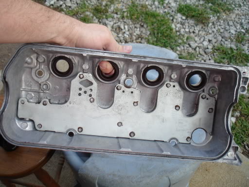

Default RE: leaky valve cover gasket on 98DX
almost forgot... id also before aplying silicone and gasket.. get some diesel fuel and clean the valve cover real good
that way thiers no left over fluid on it that would keep it from sealing properly...
i used a bucket and a gallon of diesel and a brush and then some strong engine cleaner for the tight spots and parts i couldnt reach. worked great!
sorry tho forgot before pics... tho trust me it was dirty!

and if it hasnt already been done slap alittle paint on it to realy clean it up
