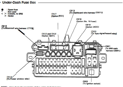

Old Jan 4, 2010 | 06:11 PM
Code 0 typically means the ECU is not getting proper power or ground.
Have you properly tested or resoldered the main relay. If not, do this first. Also check fuses 31, 24, and 18. You can't tell if they are bad by looking at them, so replace them with known good fuses.
Next clean and tighten the critical ground wire attached to the thermostat housing.
Old Jan 5, 2010 | 11:25 AM
civic94honda's Avatar
Joined: Nov 2009
Posts: 37
yes, main relay is in good shape and the ground is secure, i only checked the ecu fuse under the hood and now i will replace others to see if it cures it
Old Jan 5, 2010 | 11:36 AM
The ground can become corroded, so also clean it to a shiny metallic luster to ensure good electrical contact.
This is the proper way to test fuses.
