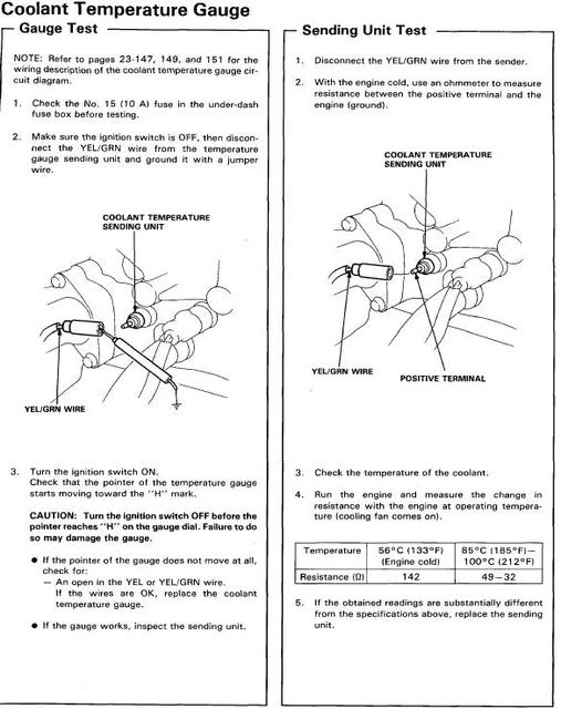

Well, you have to figure out if the temp gauge reading is correct...
This sensor (sending unit) is located under the distributor. It has 1 wire coming from it. To remove the 1 wire, pull from the base.
If your temperature IS correct and your car IS overheating check the coolant, is it there!? lol
Also, check the thermostat as it may have failed.
My old thermostat failed closed (engine will overheat). My new thermostat fails open (the engine will take forever to get up to temperature).
