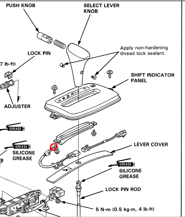

Hello all,
i have a 93 civic dx andthe light at my shifting gear are busted. how am i be able to fix these problem. anybody here who hadreplaced that light before? im just getting frustrated, especially at night, because i have to look at my dash to see if i had put it at the right gear. can anyone help me. thanks!!!

This picture shows how to access the bulb:

thanks for the reply. but how far is the light bulb? i don't see it in the diagram. don't want to tear them all and not find that bulb.

Now bulb is circled in red:

The bulb will be a 194 or 168 (either should work)
