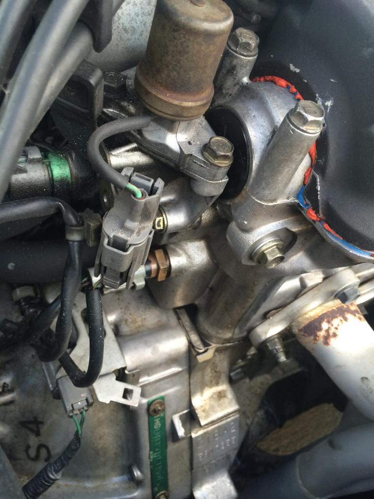

part is in front of distributor on engine has a sensor or 2 connected to it..oil maybe leaking here wanted to get name of part to order a gasket, please help

That must be a DOHC engine which was not used in the USA, but the thing with the light green wire and the rusty dome on top is the VTEC solenoid.
The black plastic cam plug behind it is also really prone to leak oil.
