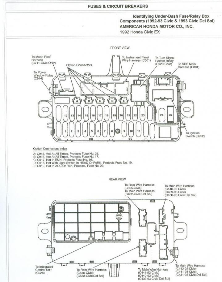

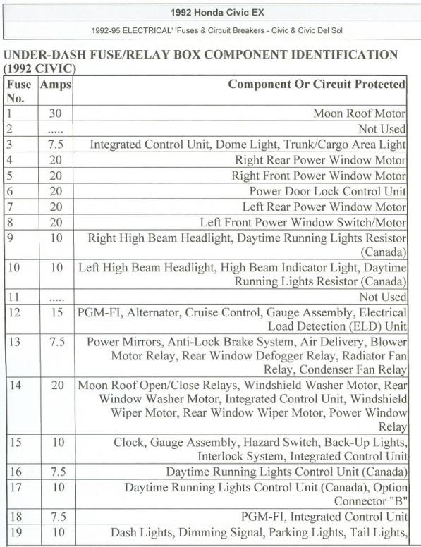

First off for years my speedo been acting weird on and off. It finally gave out and i thought the sensor gave out didnt want to buy until not i go and buy 1 cost 80 dollars and it didnt fix the problem so i have no clue unless its the cluster itself. Also i go tuurn on my dash lights they not working i was messing with fuses so i probably put the fuse in the wrong place well i dont have a fuse diagram. any1 have one for a 93 civic cx non power windows and doors.

try to match this one up with the one you got good luck

this is the second pg

thanks for the fuse diagrams they help a little bit. But does any1 know about the speedo problem.
