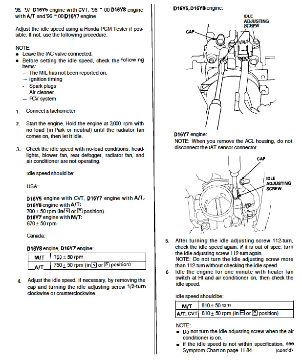

Did you already try adjusting the idle screw on the throttle body? This procedure requires a tach or scan tool to measure accurately engine rpms. The dash tach is inadequate for this purpose.

nope. could I rent the tool from autozone? or would I have to go to a mechanic?
If I can rent it, is their already a thread on adjusting the idle screw to the right position?
Old Jul 20, 2009 | 07:46 PM
Call some auto parts stores about renting or borrowing an OBDII scan tool that reads engine rpm.
See my previous post.

O :P sorry, Didnt wait for the picture to load.
