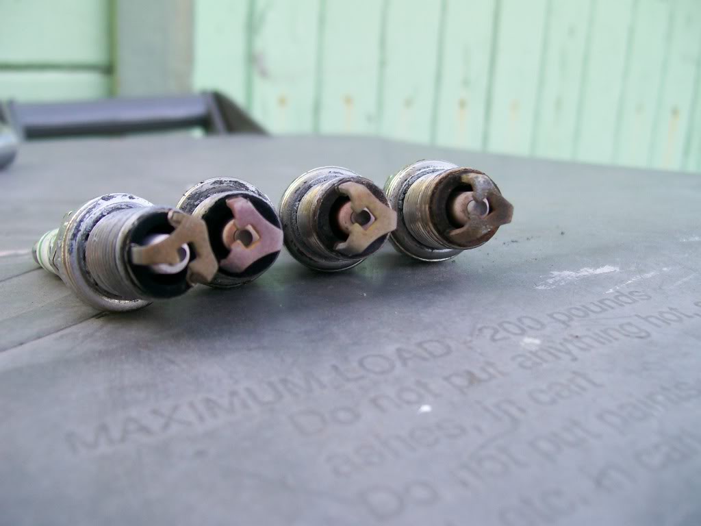

theres your picture

How did you do that ?? Any way, so I just pulled the fuel pump fuse and had granny turn the engine over, but no spark from any? I ran the plug attached to the wire up against the power stewering pump ground wire bolt....

you copied the direct link ..... copy the IMG link its like the last link below your photo
let granny sleep its late lol
do you mean you used 1 plug wire and tested all plugs on same wire???

No. I started with #1 plug and wire, and saw no spark, so I pulled off #2 wire and plug, ran it so the electrode was touching the bolt head for the ground wire, and saw so spark either....

did you put fuse back in and check?

Yep, you gota have the fuse in for sparky. I checked #1 and #2 again, they both have the same ammount of oarnge spark. Its getting dark so I will check the voltage tomorrow
