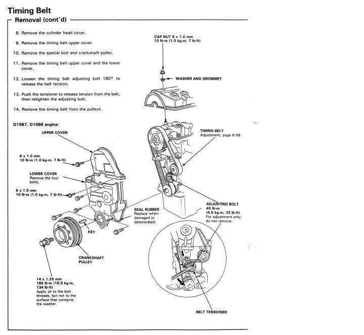

Ok guys, Im at a stopping point for tonight. My question is for the upper drivers motor mount. It looks like I need to remove the cruise control to get to the 3rd bolt, and also the bolt underneath the braket that bolts into the timing cover, do I need to jack the motor up to get a better angle in order to get it>>> Now, part 2.>>> In order for me to jack up the motor, do I need to remove the air compressor and the giant braket that has the bolt for the lower mount. It looks like if I dont it will hit the frame when I jack it up ? Sorry for all the questions, but I really need the advice and appreciate all the help so far.
Old Aug 5, 2009 | 06:37 PM
  #73
HERE ya go i finally found a good thread for you this will help you out and has good pics
http://www.honda-tech.com/showthread.php?t=649277
and this diagram
