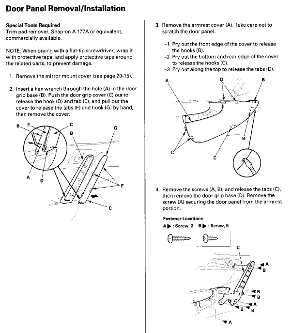

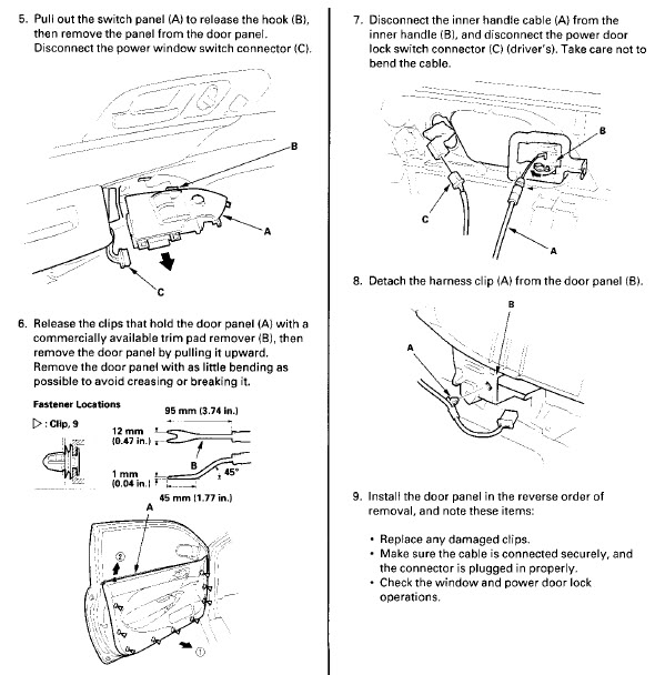

Hello, I have a 2004 Honda Civic Si. Yesterday morning when myself and my roomate got to work, he had to open the door handle real hard to get out, now the door wont close, and the handle has no resistance, as though it came unhooked somewhere. How can I get the door panel off of my car....I didnt see any screws or anything.
