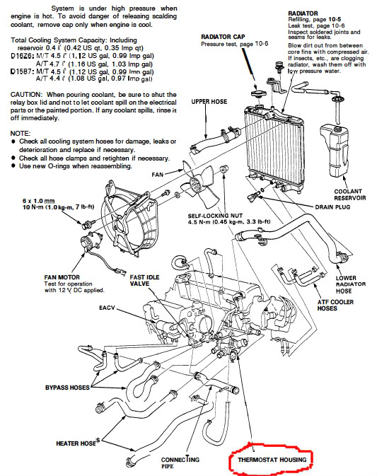

ron, sorry for lots of stupid questions, but can you point out the general area of the thermostat housing?
Again sry for all these questions.
Thanks
Old Sep 1, 2008 | 07:13 AM
No problem. Here you go:

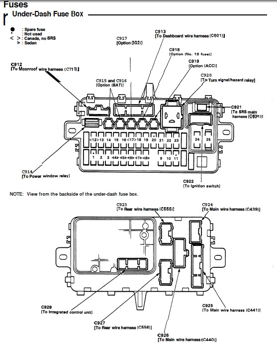

By the way, the location of fuse 24 in the SRS fuse block of the under-dash fuse/relay box is shown below.
