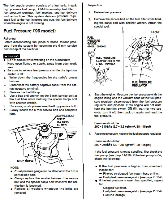

As you mentioned, measure the fuel pressure. If it's out of spec, you might have a bad fuel pump or fuel pressure regulator.

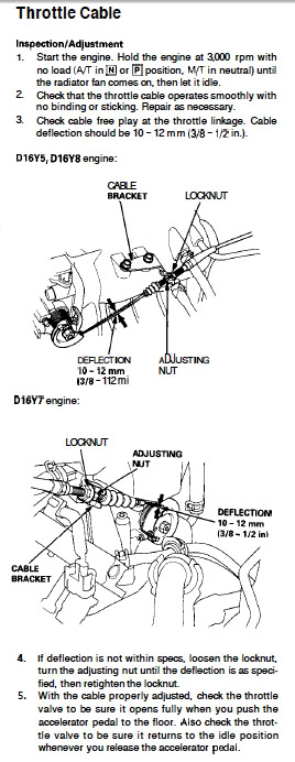

I will check the throttle cable.
How much PSI should the fuel pressure be?

Default RE: Power loss
ORIGINAL: Perry
Thanks for the fast reply Ron.
The CEL is not on.

After the seafoam treatment and sitting overnight, the problem seems to have been fixed. It is much more responsve now. Maybe the injectors needed to be cleaned. The new fuel filter also seemed to help as well.
Ron those graphics you posted are very helpful. The throttle cable had almost 3/4" of play in it. It is now within specs.
