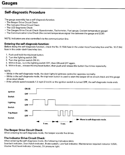

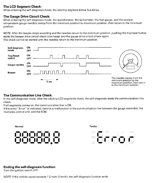

Have you run the self diagnosis test on the cluster?

Old Jul 11, 2011 | 12:34 PM
