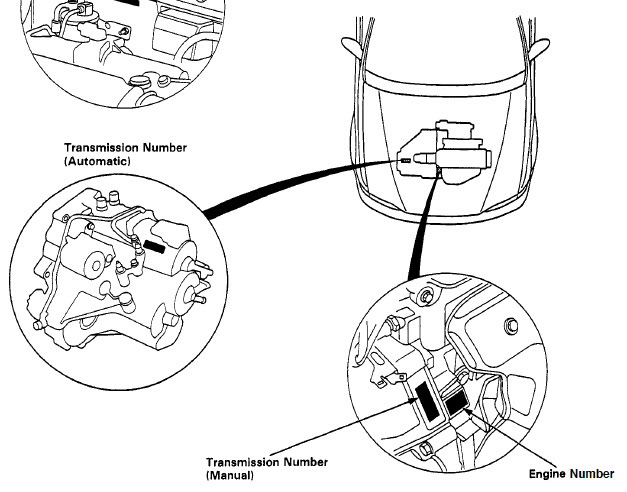

Definitely match the water pump to the engine. The type of engine that you have should be stamped on the block.

Look on the front of the engine block, about mid-height. Next to the exhaust manifold & right alongside the split-line between engine & transmission. Theres a small flat surface with serial numbers stamped in it.
D15A4 or something like that.
Tell us also the first digit of the serial # right there below the engine type.
