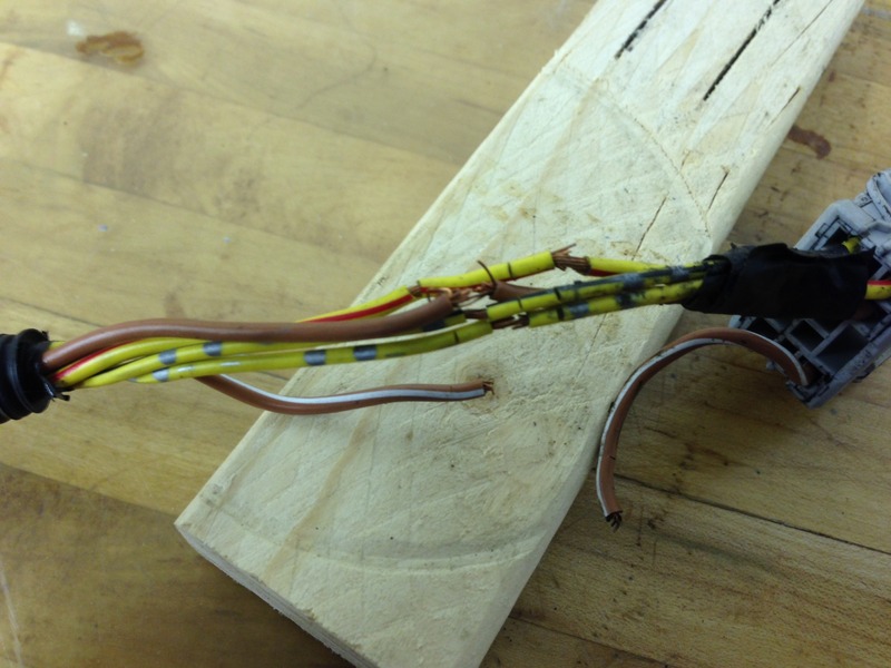

Found the problem
This has occurred to a few people on this forum from what I saw from searching. I live in Canada and it seems that the wire insulation disintegrates at the rear door flex point, probably during our cold winters.
The best solution would be to replace the rear door harness which plugs in at the door jam. While I was able to pull a couple of the plugs through the door boot, I'm sure the larger connectors are not going to fit without ripping the rubber. So my solution will be to cut the connectors off and resolder them once through the boot. The harness is $34 here in Canada and this is one item I would not advise getting from the scrapyard as the age of the wire insulation seems to be the problem.
