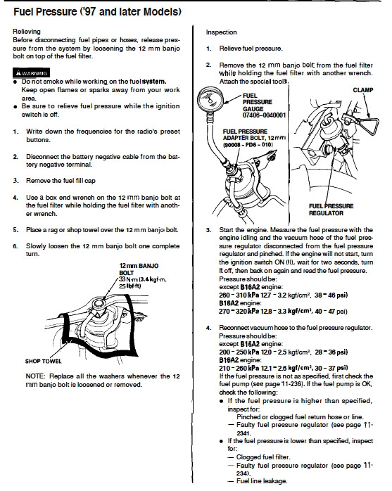

P0131 indicates a problem with the primary O2 sensor, the ECU, or the fuel pressure. Therefore, you may have replaced an expensive catalytic converter unnecessarily. Did you replace the primary or secondary O2 sensor? If you replaced the primary O2 sensor, then I'd suggest that you next measure the fuel pressure:
