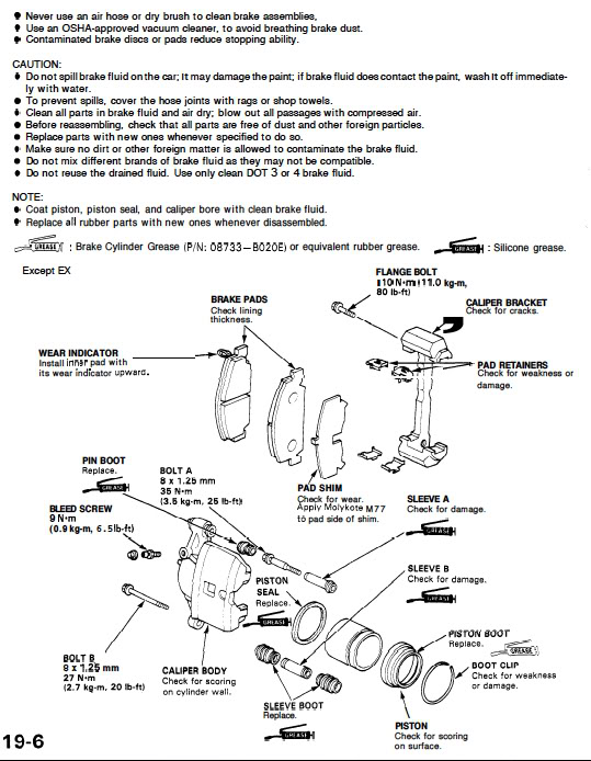

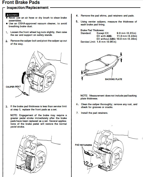

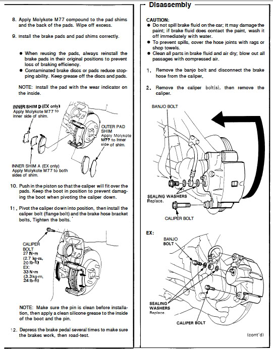

Are the pins you guys are referring to the mounting bolts that I took off or the two with the rubber boots? And how do I get them off and lube them?
Thanks for any replys!
Old Sep 17, 2008 | 09:14 PM
These diagrams may help:

Regarding the bolts, are you guys referring to Bolt A and B of Rons diagram?
Is this what O should remove and grease?
Thanks for all the help!
