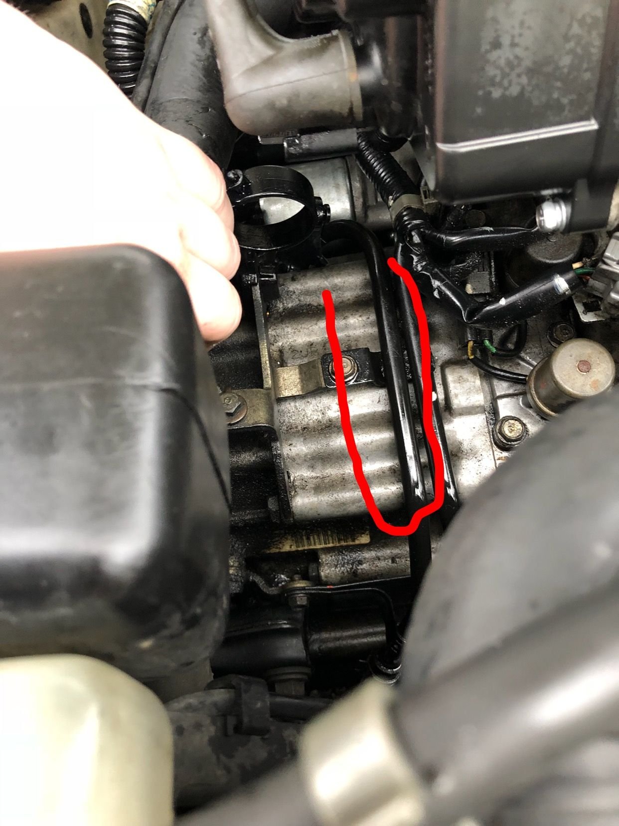

^^^^^ turns out it wasn’t oil going everywhere it was transmission fluid. The culprit is the photo above so Can anyone tell me what this is called? It has a hole in it so it needs to be replaced but I’m not sure the proper name of it to order it. Thanks

I don't know the name of it but its probably something like a transmission oil line going to or from the the cooler. Don't drive the car without trans fluid obviously. You'll overheat/ruin the trans pretty quickly, or the car just won't move. I have limited experience with automatic vehicles to be honest. Glad to hear that you were able to find the source however. Now, fix it and get the car back on the road!

Thanks for the reply definitely not driving, the amount of fluid that came out was astonishing considering the hole is about the size of a pen tip. So far I’ve found that it is most likely transmission cooling line as you said. Like you I’m not too familiar with automatics I try to avoid them but I got a great buy on this vehicle and it’s been great until the starter now this. I’m still searching around for the part then hopefully she’ll be ready to roll!

My suggestion would be to remove the tube and clean it up. Then find someone who can TIG weld the hole. The tube will be good as new and won't cost you much to have welded compared to a new tube. Good luck.

Thanks for the reply Duane I was able to use JB weld, still didn’t fix the issue. I then removed the pipe and it it had quite a bit of rust so I actually ended up getting a replacement from the junkyard ($19 not too bad) cleaned it up and it was in great shape. The banjo bolt was slightly stripped and washers were actually warped as well so I’ve got the banjo bolt on order. I’ll post an update when everything is reassembled. PS if anyone has the B15B7, finding the actual transmission cooler line pipe is a NIGHTMARE! I just happened to luck up with the find.
