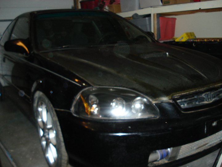

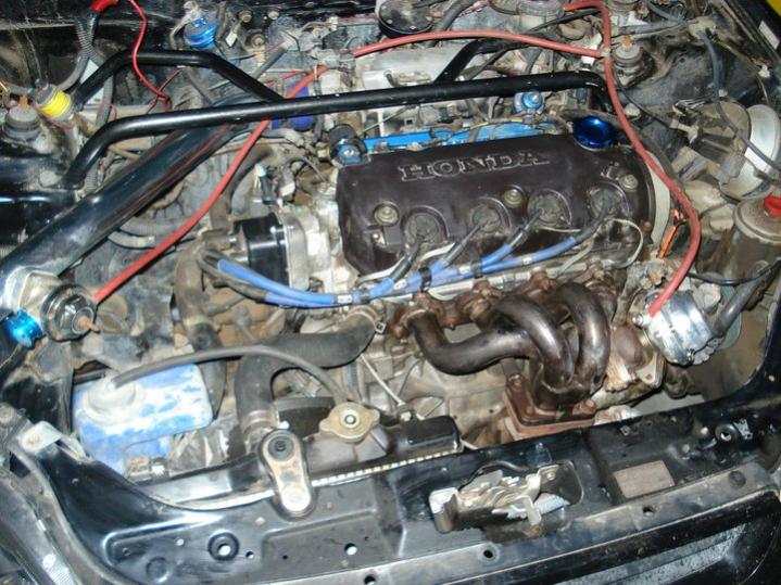

So i just bought a 98 ex from a guy in the air force and he has had it sitting there for a year he said when he came back it just wouldnt turn over so today i finally got it towed here i put in a new battery and i turn on the accessories id like to believe it was the fuel pump turning on and when i turned it over it tryed something but no spark so people say i need to siphon the old gas out do i need a new fuel pump or fuel filter oil spark plugs ect also how often should i change the tranny fluid? also its turbo and the guy said it was tuned on 7 psi do i need to do any for that? any help is appreciated thanks heres some pic btw

Did you check for actual spark at the plug wires? No spark means there's a problem unrelated to the fuel system-- no power to distributor and/or ECU, rotor screw fell out, stripped timing belt, bad coil, ICM or ECU, etc. One hint here is never believe anything the seller tells you about a used car.
If all systems check out normal but it doesn't start, stale gas can do that. Drain and replace it. It's hard to get it all out by siphoning. Use the drain plug, (I think a '98 has one) or disconnect one of the hoses under the hood, divert into a container, and jump the fuel pump to stay on.

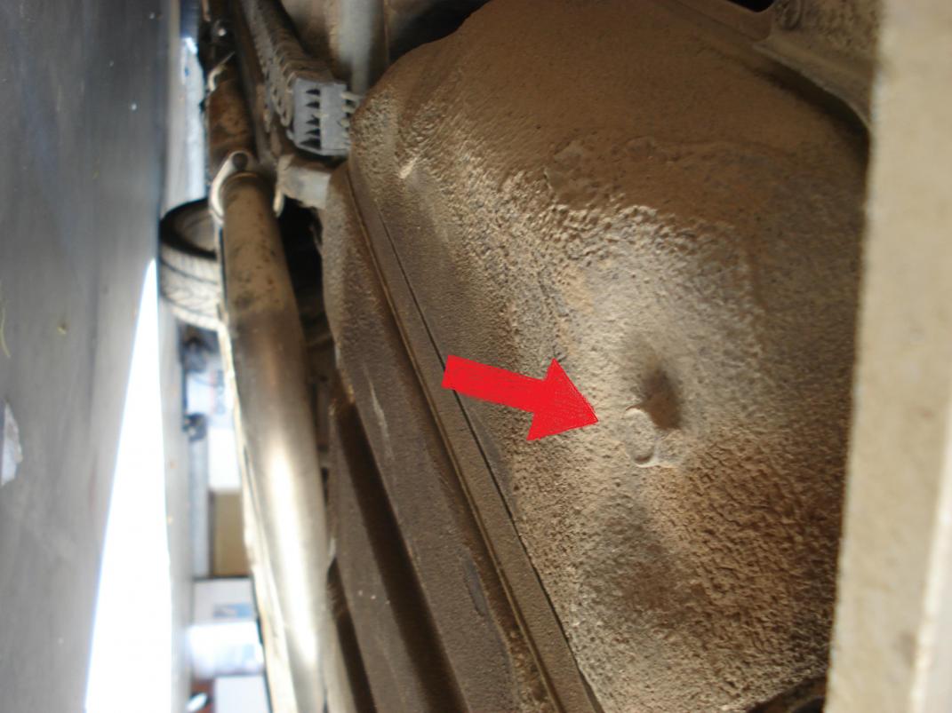

no i was by myself so i couldnt check the actuall spark i have a buddy coming over today who should be able to help with that. Also heres a pic of the underneath is that bolt the drain plug?

Yes it has a metal gasket similar to the drain on a steel oil pan. You should use a new gasket when putting it back but not absolutely essential. Also like an oil pan, don't overtighten it, and check for leaks.
