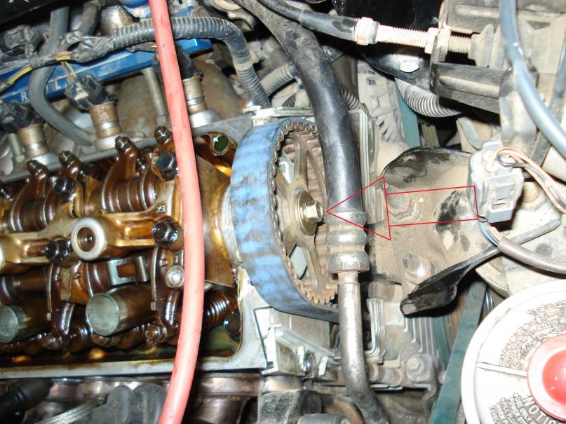

Just to make sure this is what im trying to move? it wouldnt move either way using the 12 nut on it.
went to auto zone and had the starter checked they said it was good.

No. You don't want turn that. It is a cam gear bolt.

What you want turn is crankshaft which is going to turn the cam anyways, but crank pulley bolt is secured with a lot more torque and is with bigger hex, like 17 or 19.
You can gain access to the crankshaft pulley by removing left front tire. You should be able to turn it with a 3/8" breaker bar, or regular length 3/8" ratchet if you are strong. If it was me, I will have long extension connected out enough to clear the body supported by floor jack and use 1/2" breaker bar for effortless turn.
Anyways, you should be able to turn with some drag but not with grinding sound.
