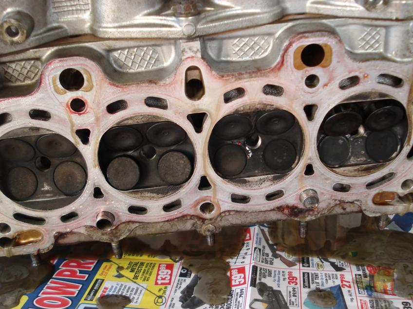

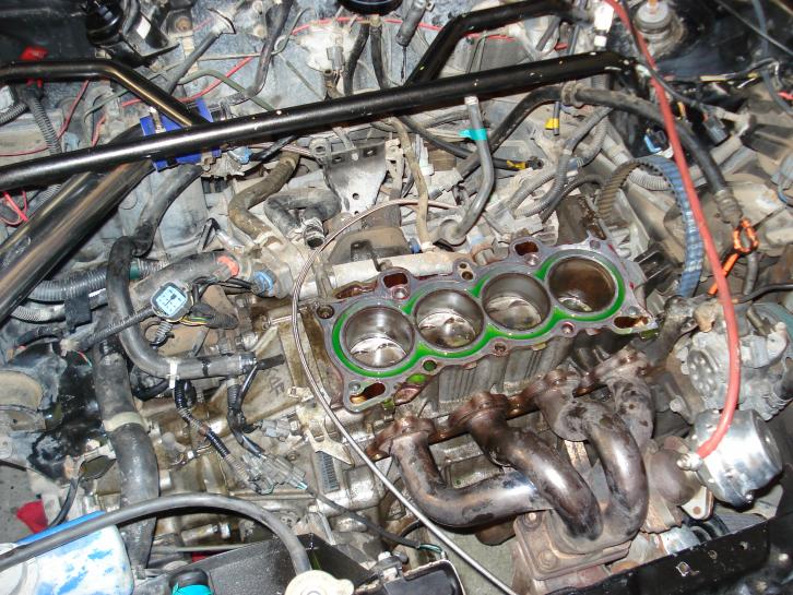

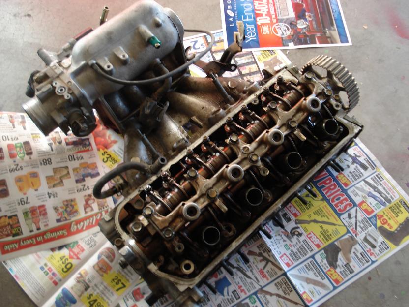

So I pulled apart the head today here's some pics, would i be able to tell if the head is cracked? also would i be able to see if the block is cracked?

Cracks are usually not that easy to see with naked eyes. Most of times, I need to perform dye-penetrant inspection or other types of inspection on things I work with (aircraft engines).
There is something wrong with #1 cylinder I can see, though. It seems like it is having way too much of blow by, Compression rings are not making contact with cylinder wall.
Old Dec 26, 2010 | 11:50 PM

How do i fix that?

Your block would have to come off of the car and sent out to a engine rebuild shop for inspection and honing job, at least. You will need new sets of rings among other parts. There will be a lot more work would be required, done on the engine. It's better for you to call your local engine shop and seek their advise.

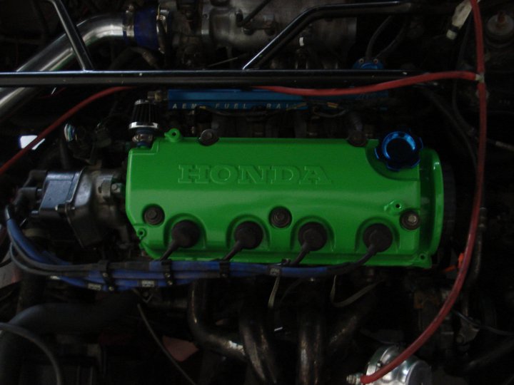

Well i changed the HG to see if the coolant would stop mixing with the oil and it still did so a guy is selling a d16z6 block with a y8 head 130k for 200$ im assuming i can just swap it out and it should work right? also i would be using my d16y8 trans. i have already, along with the turbo and ecu setup. here's some pics of the engine bay i cleaned it up and sprayed the valve cover.

Swapping engines to this and that is something I have no knowledge of. I assume it is less expensive than doing the work on existing engine. A lot quicker and easier way as well, provided the new engine you are going to install does not come with any problem just as your first engine had. Doing it quicker and easier sometimes contribute less to your experience/memory bank.
Valve cover looks good, though, green is not my favorite color.
