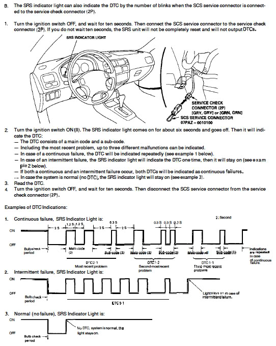

So i swung by the honda dealer today to ask them about the good ol' srs light being on... well i got this spiel about it being caused by my seatbelt locking up... and this really doesnt make sense to me because the seatbelts lock up on other vehicles all the time without causingthe srs light to go on. They said that it would be a 100 dollar an hour diagnostic to find out if this is the problem. So being a cheapskate i dont really wanna pay 100 bucks or possibly more so could anyone tell me an easier way to tell this? could i just read the error code or something?

Yes:
http://hondatech.info/downloads/Auto/Manuals/Civic/

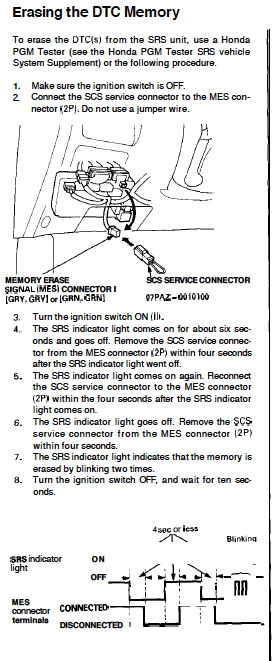

Thanks but i kinda dont have a Honda PGM Tester to erase the DTC memory.

Please read further in the manual for jumper wire method:

I have looked for hours and I still can't find this freaking MES connector on my 1997 EX, is it on the front side or the back side of the fuse panel?
