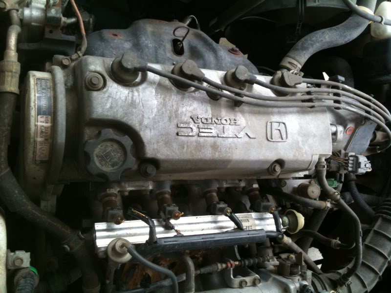

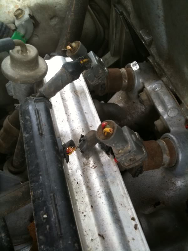

I hate squirrels. This is what one did to my engine wiring harness:

The wiring harness costs $400. I'd like to just splice it somehow. Any tips/suggestions?

Find one at a junkyard. If you can't find a complete harness off a Civic, those same fuel injector plugs were used on a lot of Japanese cars. Then of course you would have to splice. Open up the black plastic part and unwrap the tape to find the other ends of the wires.
Old Oct 23, 2009 | 09:02 AM
just find one in the junkyard or look on ebay and cut the injector plugs off and just rewire them back in on ur civic
