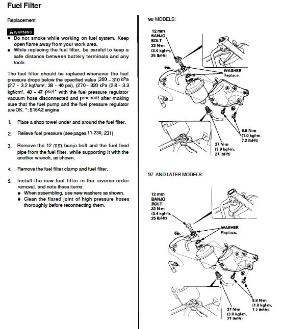

I thought that the dealer had replaced the fuel filter when they did the 60k service on it last May, but I just looked at the work order and I don't see that on there anywhere. I need to have it inspected this month so maybe I will have them check the timing and the fuel pressure while it is there since its almost the end of the semester and I'm kinda short on time, I would do it otherwise. How hard is it to change the fuel filter? I've never done it before... Thanks guys!

Thanks guys, I'm taking my car to get inspected Friday and I told the service guy about the problem and he said that the mechanic would take a look. I hate asking them to do it because I would much rather do it myself but with finals coming up soon I just don't have the time to do it. If they can find something and its going to cost a lot to have them do it, I will wait and try to do it myself when I'm done with finals. The service guy seemed to think that the fuel filter was in the tank and a lifetime part, but other places I've seen and the picture you posted, show one in the engine compartment, and I looked this morning and it's definately on the firewall. The service schedule I've seen says to change it around 60,000 miles, so it would have been done (hopefully) when I had the service done last may. Hopefully since I used the Honda parts to do the tune up last time they won't just assume that that is the problem and they may actually find something this time... Thanks again for the help guys! Much appreciated
