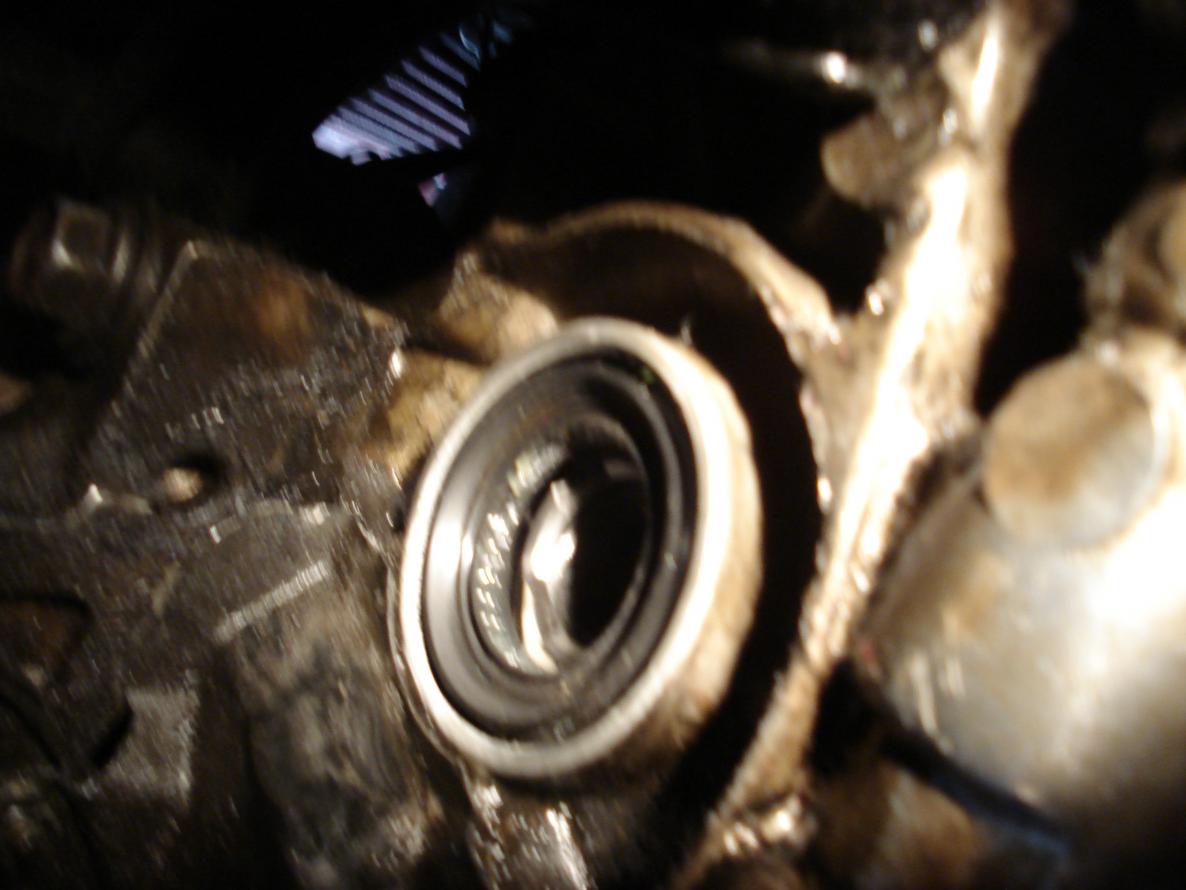

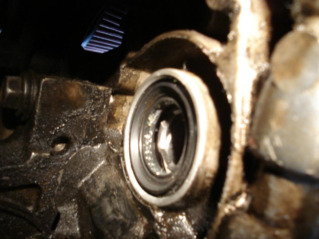

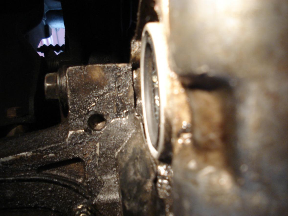

okay so today i bought 2 new seals this is the drivers side seal lemme know if this if flush enough
