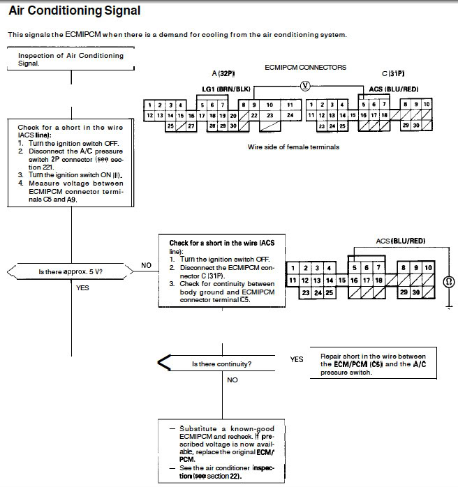

When that A/C is on, a signal is sent to the ECU, which then signals the IACV to increase idle speed in order to compensate for increased engine load. The ECU is either receiving erroneous signals or sending erroneous signals to the IACV or the IACV is not responding correctly to the signals.
Start by cleaning the IACV as mentioned by mk (see forum DIY). If cleaning the IACV doesn't solve the problem, use a multimeter to troubleshoot the ECU as described in the diagram:
