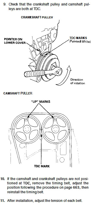

Maybe somehow the rotor is on wrong. You should check the timing, make sure the rotor points at wire #1 when the engine is set to TDC1.

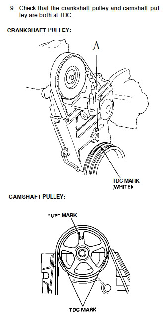

U.S. or Canada Si?
Is spark bright white?
Below is the correct firing order on the distributor cap. The cylinders are ordered 4-3-2-1 from the distributor to the timing belt.
Below is also shown the correct mechanical timing for the U.S. and Canada Civic Si.

Originally Posted by RonJ
U.S. or Canada Si?
canadian i believe. the plug order is definatly correct, I will check the timing next, thanks guys!
Old Mar 28, 2010 | 02:30 PM
Civic Si: US = DOHC; Canada = SOHC
Old Mar 28, 2010 | 03:38 PM
20sir00's Avatar
Joined: Mar 2010
Posts: 3
My bad, defiatly US. DOHC
