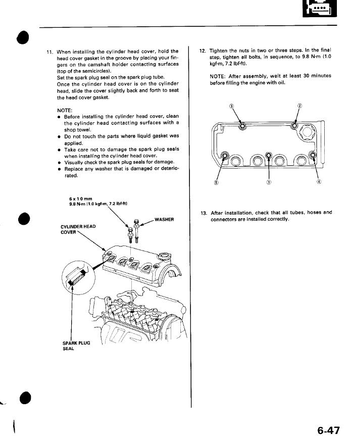

i plan on painting my valve cover soon. just wanted to know if i have to put on a new valve cover gasket and whats the order in which i need to place the bolts back on. i read somewhere that they needed be placed in a certain order. and whats the measurment that i need to tighten them. thanks

Just clean the old gasket off and reuse it... unless it's brittle and not rubbery, or if its broken. The service manual says you'll want to put some liquid gasket on the corners where the two crescents are. (You'll know it when you see it.)
Go to http://hondatech.info/downloads/Auto/Manuals/Civic/ and find the manual for your Civic. They're in PDF format. They're free. Best of all, they'll tell you everything you ever needed to know about your Civic. (I hope you have a 1992-2000 Civic. Those manuals are the most easy to use as far as I know.)
Old May 18, 2009 | 08:25 PM
I think there's a specific order, but if there is, it doesn't make much of a difference. On anything with a sequence you would go from inner to outer, so start at the most center bolt and alternate sides going in order outward

Here's the HELMS for a D16

Thanks for the info and display. Quick question tho. If the valve cover already has paint on it. Should I strip,sand paper, or just paint right over it? Thanks.

Also be very careful not to over-tighten the bolts, they break easily. If you get oil leaks with the bolts properly tightened, take the cover off and redo the gasket.
