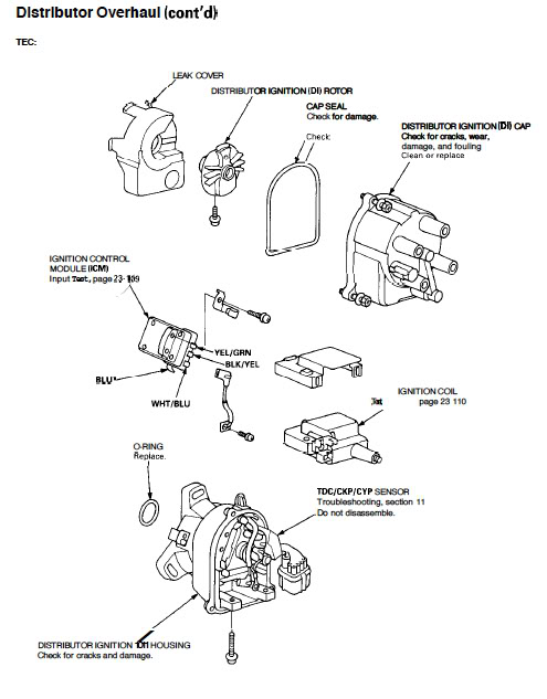

Any other codes?
Remove the coil and ICM from the distributor. If you have a multimeter, you can test the coil. Otherwise, take both to an auto parts store for testing.
