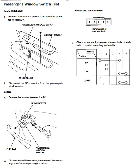

I recommend that you test the passenger's window switch because the driver's switch control of the passenger window is mediated through the passenger window switch.

Sorry, when I glanced at the alarm system circuit diagram at the link you posted, I missed the connection to the window circuit. So, yes the alarm system could be the cause. I would suggest that you also check the passenger switch, however.
Old Aug 7, 2008 | 05:20 AM
teamwhiplash09's Avatar
Joined: Jan 2008
Posts: 28
From: Tallahassee, FL
Yeah, I just printed off your chart. I'm checking that switch later today when I get off work. I don't see anywhere that says windows in that diagram I posted. But my car is FAR from stock so there's surprises around every corner...and just b/c I hear that box click when I operate the windows is what leads me to believe something's been changed from that diagram.
