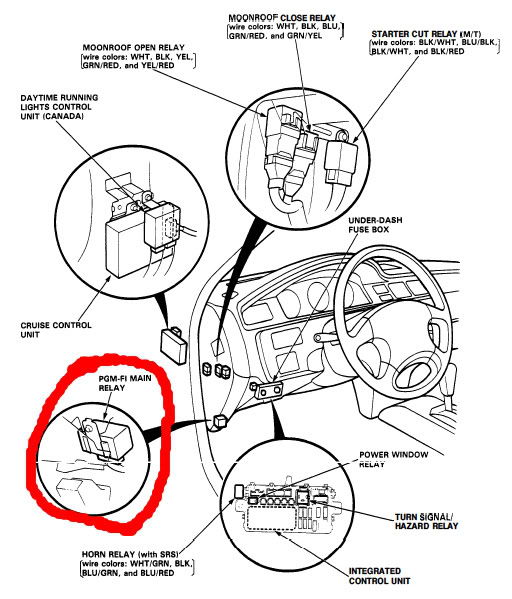

Where is the main relay and how do I check it?

ORIGINAL: saiguanas
http://techauto.awardspace.com/mainrelay.html
