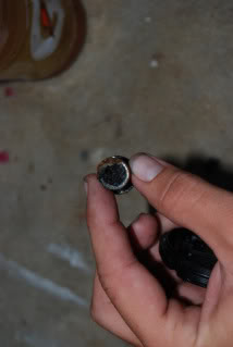

and it was plugged up by this which was filled with crap

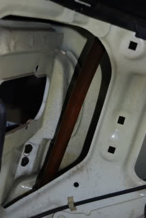

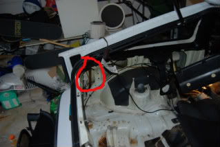

there was one on both sides in this location and felt like it went through and out of the car behind the bumper im assuming its a draining system for something
so wtf is this and would it cause water inside my car?

Does you car have a sunroof?, If so it most likely is the drain for the sunroof. Why that liquid is orange beats me.

It's the drain for the sunroof channels, it can get clogged sometimes and plug up and leak, just find the clog and clean out the system. The orange could be explained by some sort of rust from somewhere.

Its just backed up. Clean it all out with kaboom.

i had the same problem in my acura there are 2 drains 1 on each side of the sunroof what i did was get a commpressor with a blowgun and just blow out each drain the real problem is if the hose is cracked (will happen to plastic over time )its not exp its just time consuming
