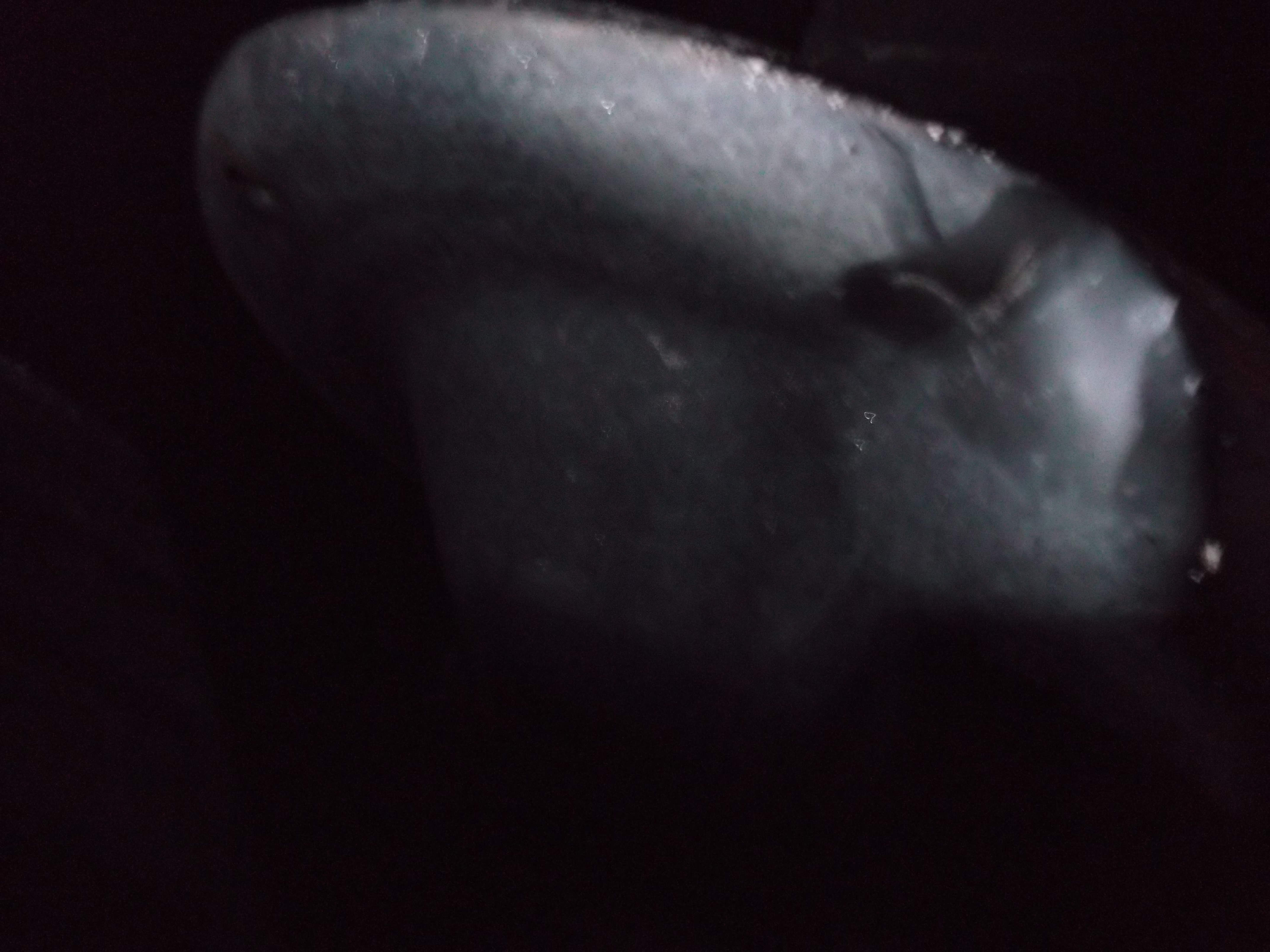

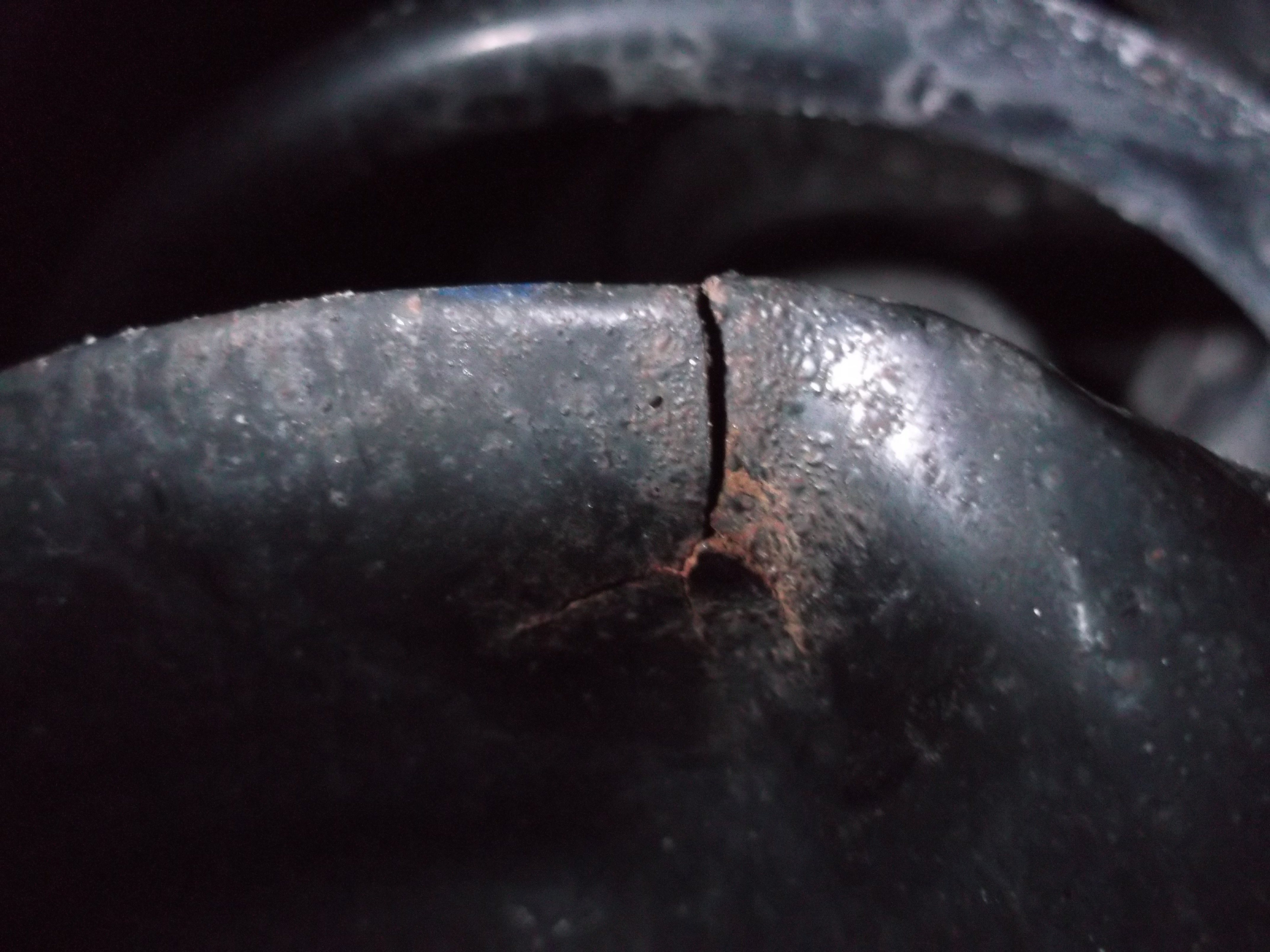

Well upon inspection I did find fractures where the spring seats.
Left side
Right side
Will they need replacing? If so, is it the whole assembly, and what do they cost usually? Thanks

You said you hit on the right but you say the damaged spring perch is on the left ???. by looking at the rust that crack has been there for a while if an impact caused that then there would most certainly be a lot more damage then this.

Yeah I agree that the crack must have been there for a while on the left side. But the fracture on the right looks fresh. Sorry for the huge pics, but is this cause for concern? Thanks.

take better pics and re-size them cuz i can't even see damage on the bottom pic Free Online Picture Resizer - Crop and Resize photos, images, or pictures online for FREE!
Hey yeah sorry... was hard to get the camera in there. The last photo is of the left side where you can see I wiped away some dirt. It is in a V shape. I will try to take a better one tonight.
