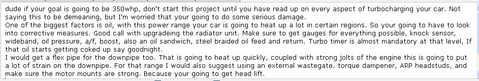

Default RE: cast or tubular mani?
to give you an idea this is just a few things off the top of my head. Be safe and make sure you know what your doing
of course my friend I know all this. Im just deciding on all the big parts right now. Im going overkill with safety all thru this motor setup. I preciate it tho man! always good to have a heads up. Im getting or already have most of that stuff! thanks tho buddy!
