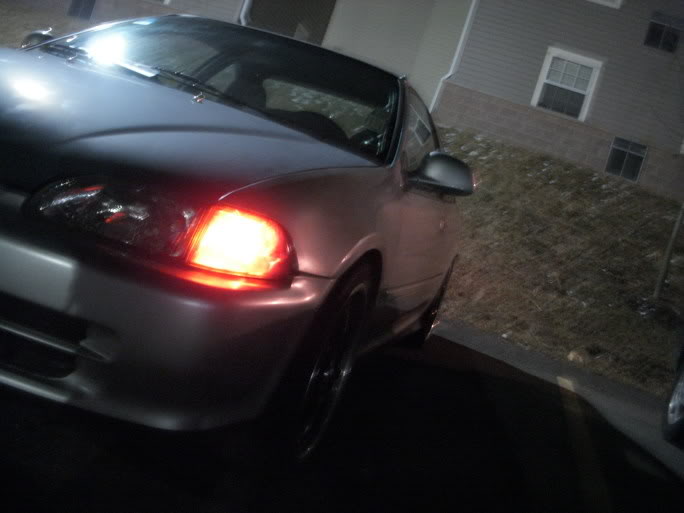

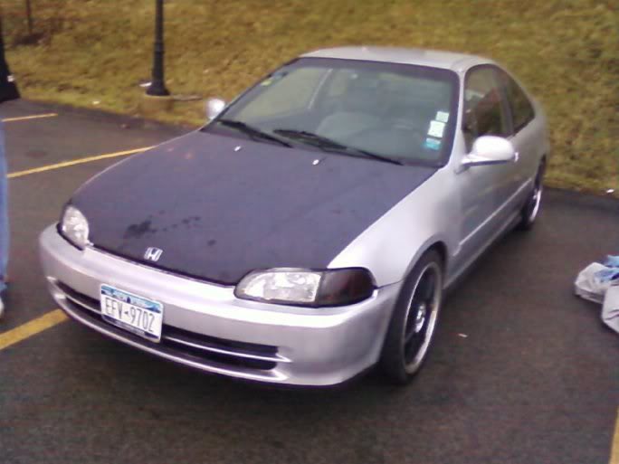

And if anyone's interested, here's pics of silv3rcoupe's civic:
