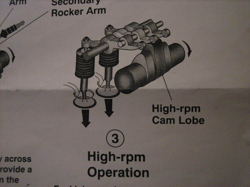

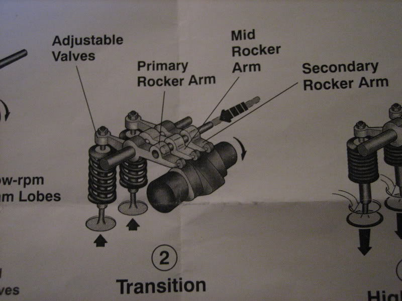

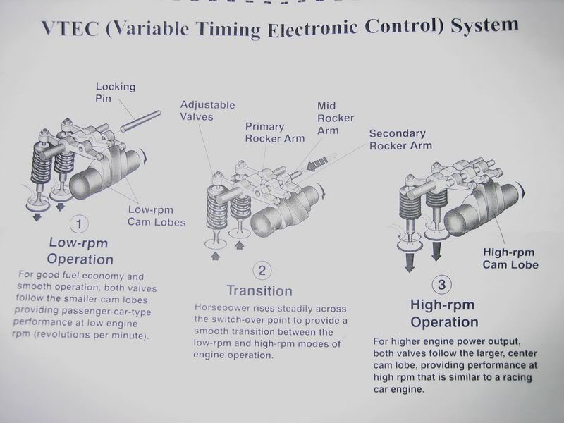

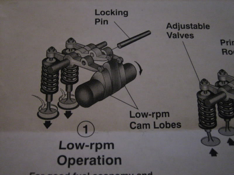

found a real sweet service manual at work that has color and pretty detailed pics of a ton of stuff from all kinda parts of the engines to suspension parts to small electronic parts such as the window controlers. found this and figured i'd share how VTAKK y0! engages.

its such a good idea yet so very simple.....Occam's Razor i guess huh?

lol
pretty simple yet brilliant!
