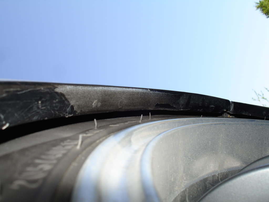

1997 Honda Civic with the following wheels and tires 17x7 40mm rolling on 205/40/17. There is some rubbing when going over bumps.
Heres a pic to give you an idea of what it looks like:
The tire is right under the fender, the only two options i see are rolling the fenders, getting coilovers, or spacers. My friend wants to upgrade his suspension anyways so he is looking at coilovers. What he is trying to accomplish is being able to take a full load where the spring is able to compress without rubbing. So what to go with:
1.) Coilovers (If he goes with this option can the ride height be set close to stock but with less compression?)
2.) New springs and struts with spacers. <- do they even make spacers for a 1997 honda?
3.) Fender Rolling.
Price range is $1000 if it can be done cheaper, then please do tell.

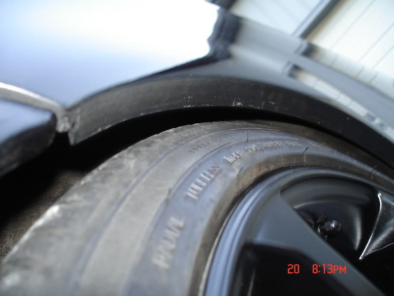

get a better picture of the actual problem area... if its rubbing on the inner fender lip DEFINITIVE ROLL THE FENDER LIPS IN!!!!!!!
if it looks like this.... if it rubs to much it will slice right thru the tires sidewall!

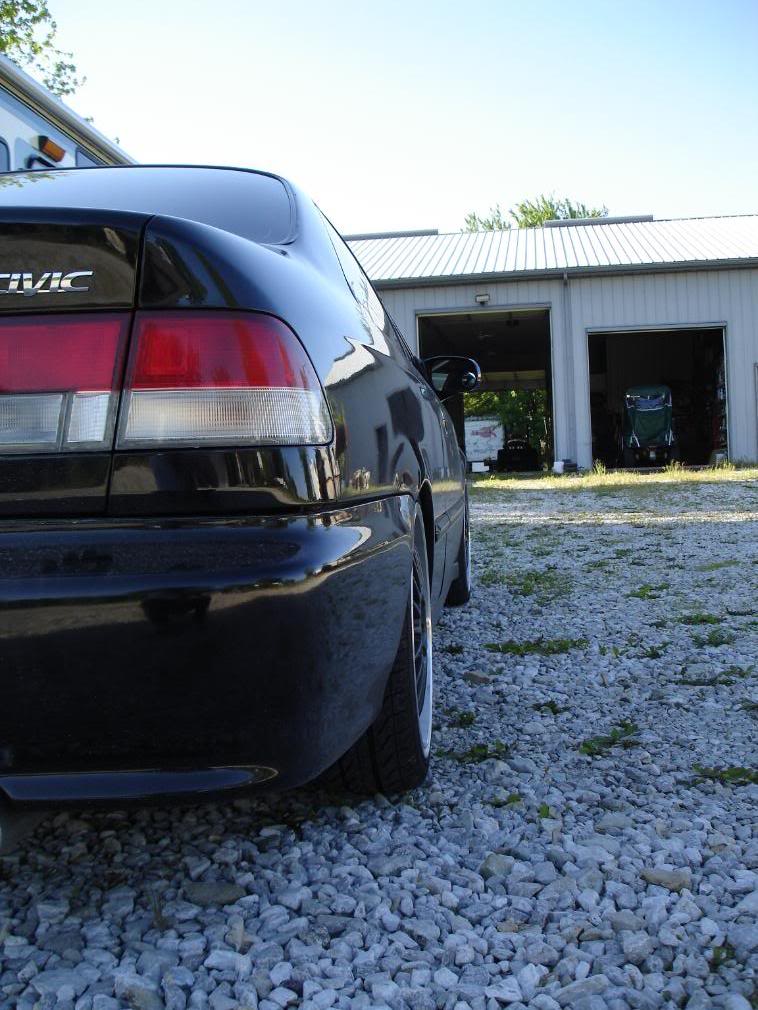

i had to roll mine on my 99 when i lowered it. BUT depending on how low ya go... ya might not need to roll the fenders if ya dont mind the gangsta tire lean... LOL SAY YES TO NEGATIVE CAMBER.

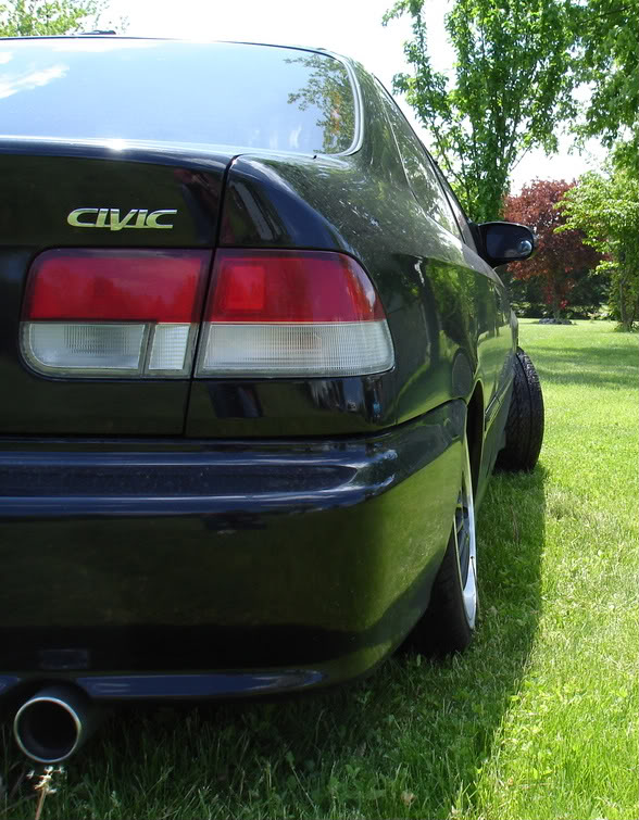

not me.LOL i rolled my fenders and have camber adjusters... thats just how that rear can sit droped low with no camber adjuster. i dont like the gangsta lean myself... but many others will rock it leaning hardcore like that with little problems! as long as the toe is set correctly and you rotate your tires regularly you shouldnt have much extra wear.

tho the camber is very close on the rear it will take more rolling to get them dead on!
