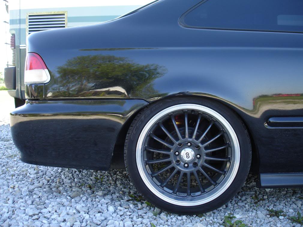

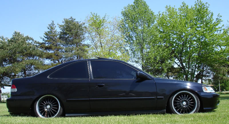

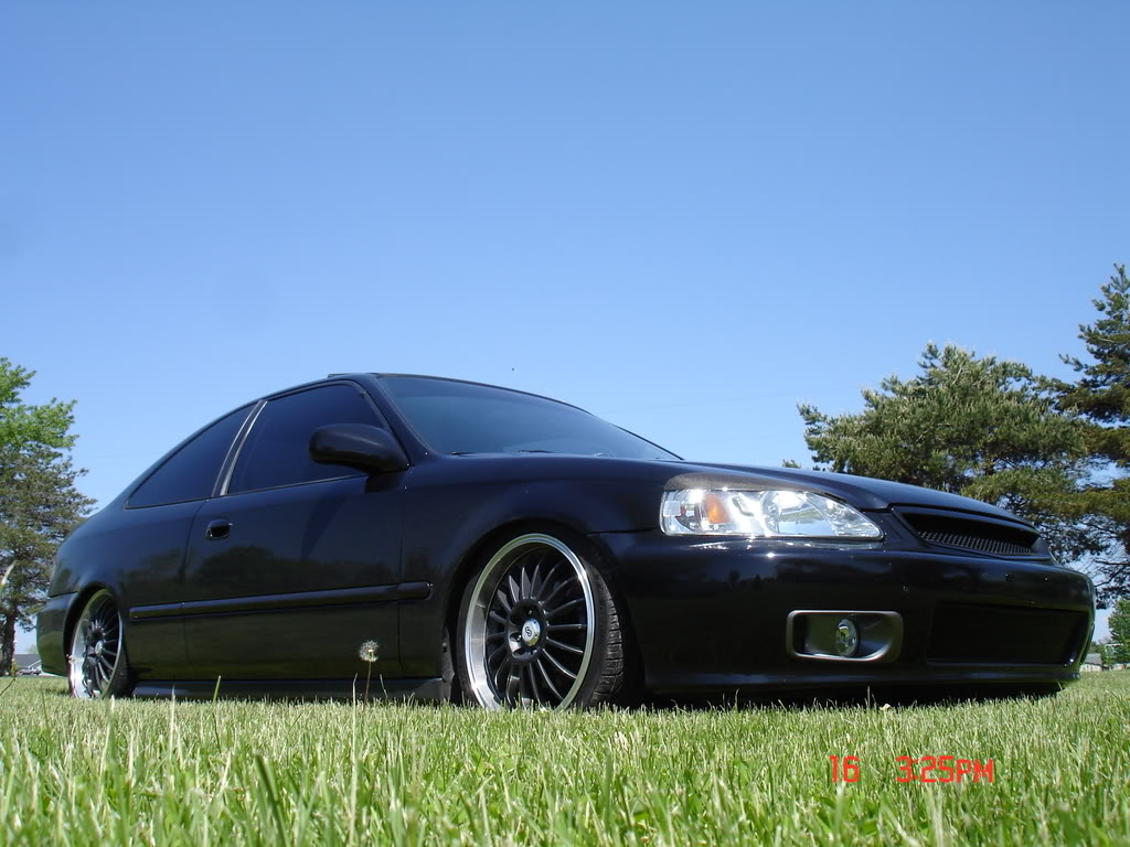

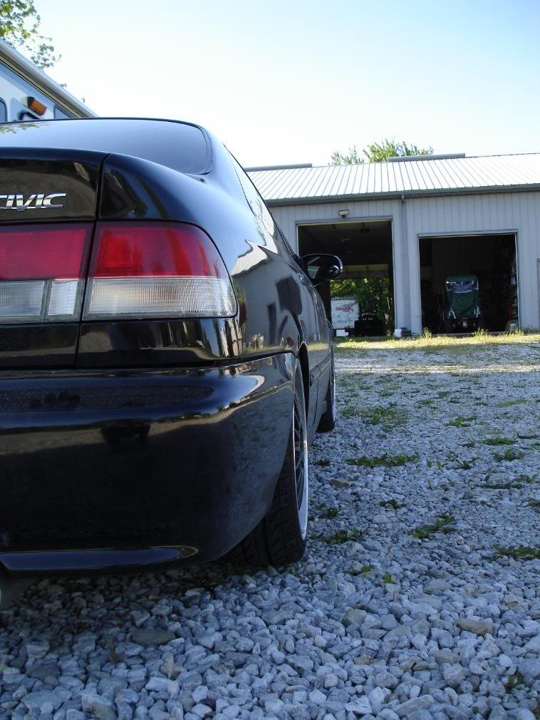

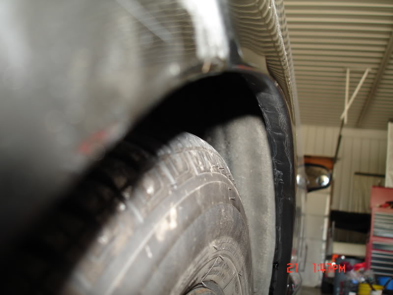

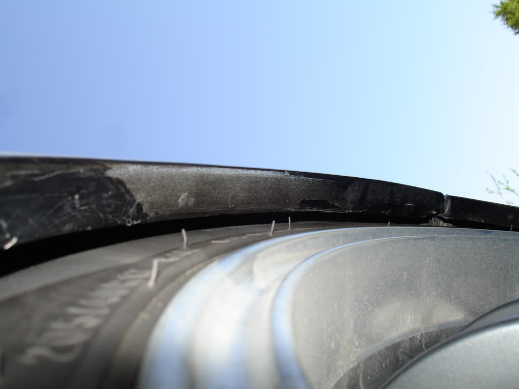

this is my old civic when i had it pretty low... i could go even lower BUT with the front i couldnt go much lower because the fronts where riding on the bump stops and for any lower i would have had to remove the inner fender splash guards, and the upper lip that sticks down i would have had to cut and roll it over flat as well to prevent cuting thru the tire ontop. and i also needed the upper extended top hats to give the front struts more travel.
simply rolling the fenders lips will bend the lip out of the way clear from the tire...
and when your rear suspension is compressed the tire is angled inwards on the top. if the tire can clear the lip youll be fine.
mine where not completly rolled flat but enough to clear the tire that worked great!
the factory lip seems to or at least ON MY black civic they looked like it was angled downwards just asking for tire shreading...
and mine didnt have those rubber covers over the lip, but my 96dx does.... tho i will pull them off and leave them off when i paint the car in the spring.

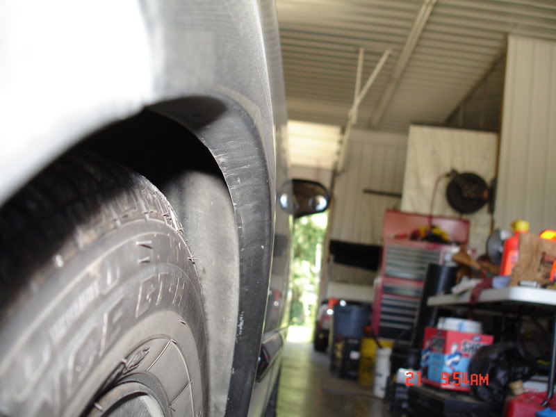

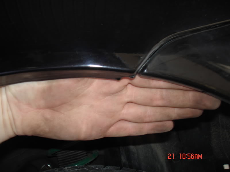

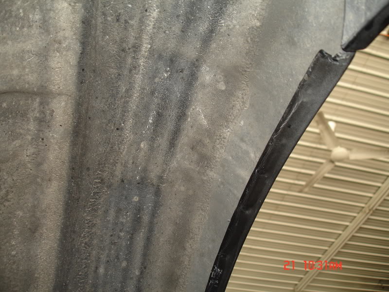

i rolled the lip just slightly up which mainly rounds the metal lip which basicaly turns the knife into a spoon so even if the tire does happen to rub it wont slice right thru it!
before ^
after
all of my rolling pictures.
http://s40.photobucket.com/albums/e2...der%20Rolling/
you can see a big difference... and its not even rolled that extreme! but it was enough for my 42mm offset wheels. since yours stick out alittle more they probably would need to be rolled alittle more than what mine looks like.

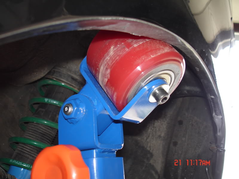

its very easy really this is basicaly all you do.... besides using a heat gun all around the lip to warm up the metal and the paint which makes the roller alittle easier and can help prevent the paint from cracking and chipping off.
and i did previously already heat the fender lip and it was a hot day and mine paint didnt really chip off but it did have some spider crack lines. and a chunk of previously repaired fender lip had some bondo that broke off but alittle spray paint and clear and no one could ever tell the difference!
and that was my first fender i rolled.
biggest PITA was when the roller poped off the back lip around the bumper cover area as you can see i kept doing by accident.LOL it doesnt hurt anything just alittle paint to roll to the edge without going to far and poping the roller off the edge.
http://www.youtube.com/watch?v=QHM-A_aFCoY
VERY EASY TO DO with the proper tool of course... beats the hell outta the ghetto fender rolling, and this is the msot popular GHETTO roller how to if your realy cheap and dont care if you mess up ur car... since it doesnt have any precision like the real tool does!
