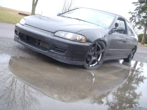

believe it or not, if you have the toe set to factory with -3* camber, you'll wear tires just like you would with the stock suspension and a good alignment. How do I know for sure? Unlike 95% of the people that talk about camber vs. toe tire wear, I'm speaking from experience.
That was my DD... put 5k miles on with it that low before I sold her, no premature tire wear whatsoever (and 3 degrees of negative camber, too)

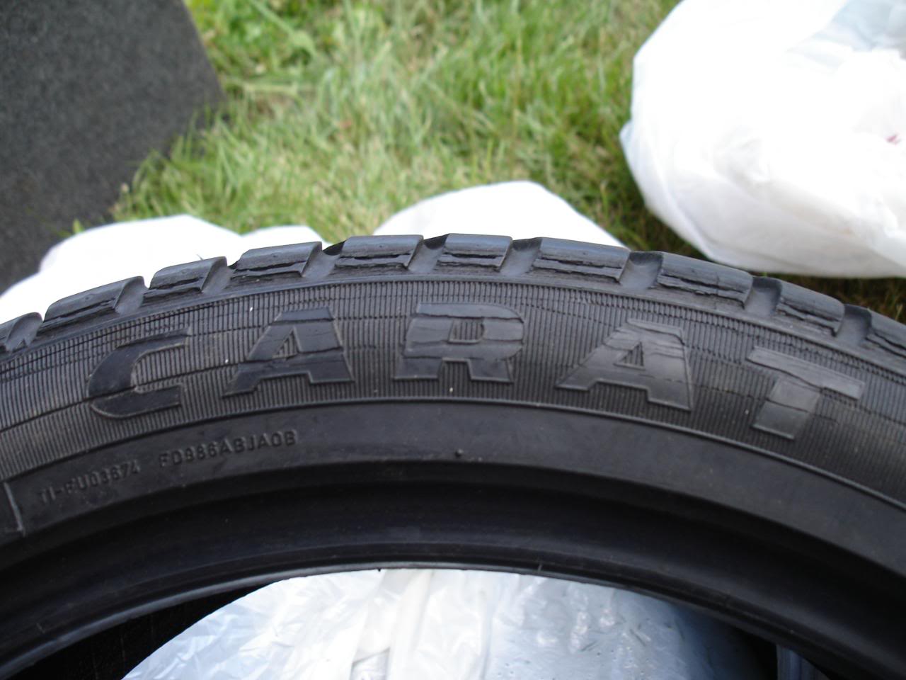

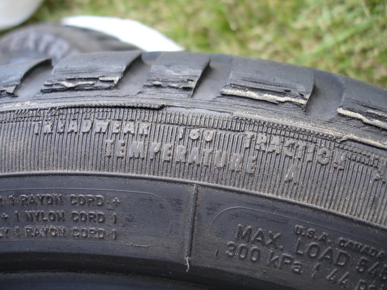

Here is a picture that shows where the car has been rubbing:
Picture with two people in the car
Get the idea, it compresses to much and rubs.
Do all coilovers lower the car even at the highest rating, or can it be set to the stock height? He doesn't want to roll his fenders so its either coilovers or stock springs with spacers. Any suggestions?

most coilovers dont lift the car up to stock height... they are designed to drop the car... like my ground controls they will drop the car from 0.5inch drop to 4inch drop.
im no tsure what the stock wheel size is BUT they are not as wide so the offset is different.
i think your wheels offset is about 36-38 offset. the best offset is 42 IMO.
BUT if the car is lowered you still need to roll the lips.
only other quick MAYBE fix would be to buy a rear camber kit and run some negative camber which would suck the top of the tire inwards some.... BUT TO WARNED i have no idea how short those camber arms will go so for all i know the shortest they will go is the stock camber arm length... i have no idea so it MIGHT NOT WORK!!!!!!
smartest thing to do is buy the fender roller tool and just roll the fender lips out of the way!
now looking at your other pictures you just posted the part that might be rubbing is just the rubber cover over the lip... its posible you could just pull that rubber cap off the lip and the tire MIGHT CLEAR... but if it doesnt clear it will cut right thru the tire even faster.... the rubber on the lip might be cusioning the rubbing which is why its not sliced thru the rubber yet, tho im sure its trying to rub thru the tire and the rubber cover so eventualy it will get alot worse!
